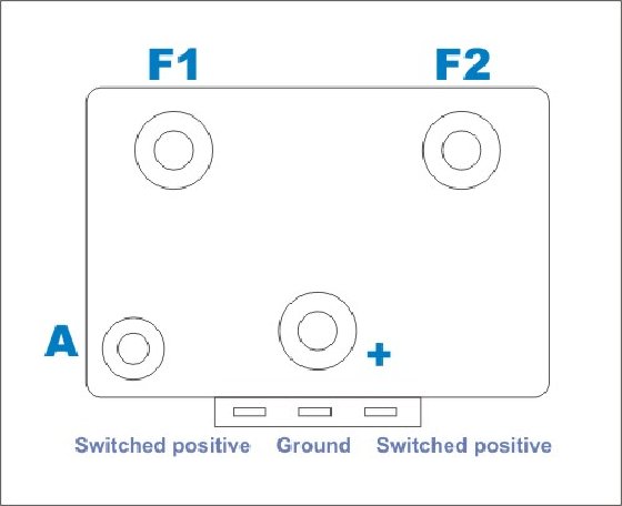

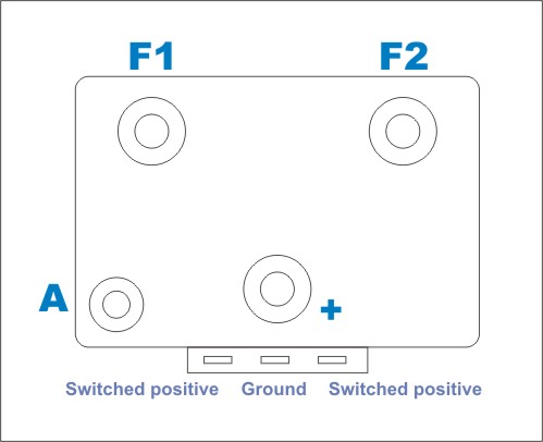

Oh, and these are the connections....
Albright solenoid pinouts
